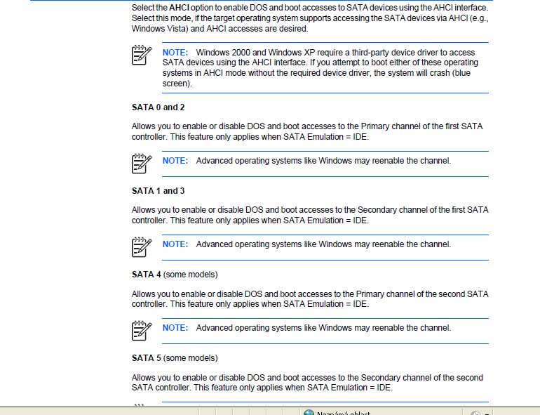

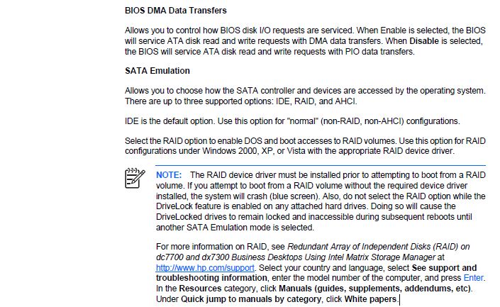

A kousek dál: "NOTE: Windows 2000 and Windows XP require a third-party device driver to access SATA devices using the AHCI interface."
Clipboard02.jpg- (82.66 KiB) Staženo 52 x
Clipboard01.jpg- (82.68 KiB) Staženo 54 x
