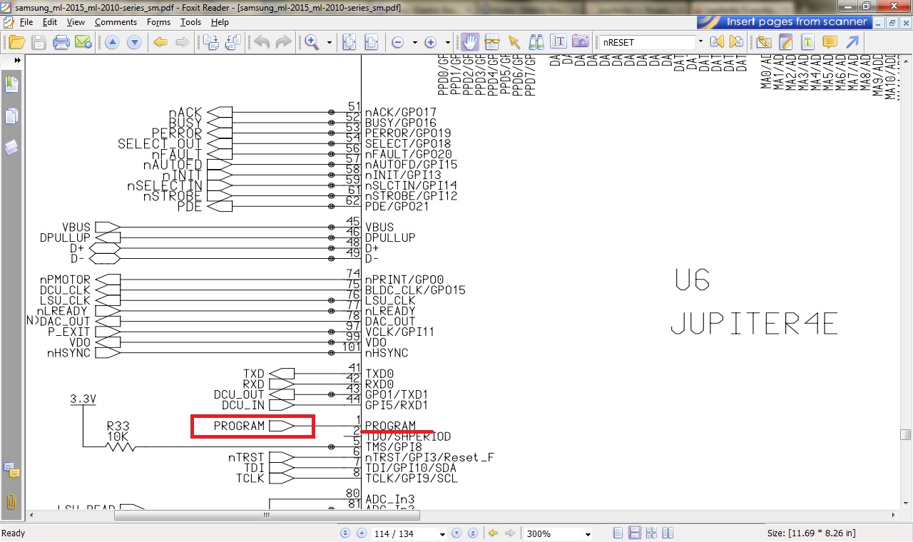

Keby bol dostupny datasheet k tomu Jupiter4E, tak je to jednoducha zalezitost - cez piny PROGRAM, SDA a SCL sa da pravdepodobne prepisat flash externe. Robia to tak asi vo vyrobe, pretoze su tieto piny vyvedene na test pointy a este aj oznacene.

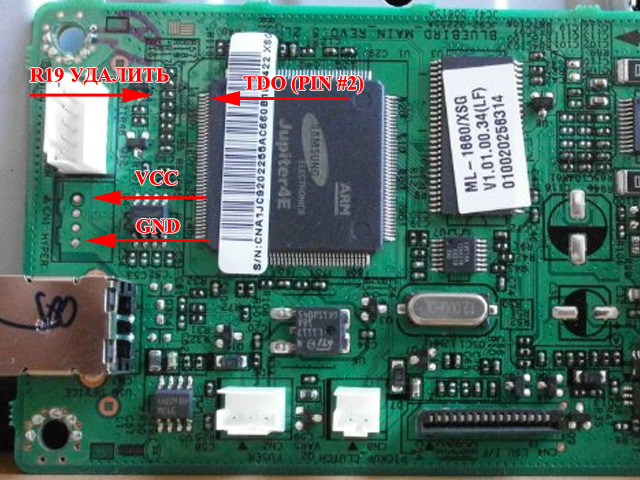

#53 Příspěvek od FlashK »
sorry translate.google...
по русски:
проблема в том, что ml-1660 с испорченной прошивкой и нужно прошить fullflash.
Я подключил jtag, в openOCD вижу процессор, но не могу настроить его для прошивки flash.
translate:
the problem is that the ml-1660 had a bad firmware and need to flash fullflash.
I connected the jtag, in openOCD see the processor, but I can not configure it for firmware flash.

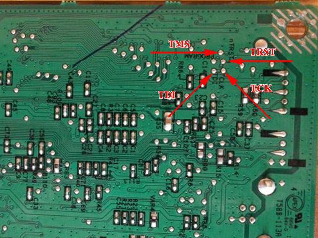

init_j4e.bin
bootloader
(31.12 KiB) Staženo 126 x
jtag
(166.26 KiB) Staženo 110 x
jtag
(173 KiB) Staženo 155 x
Příspěvky: 37419
#54 Příspěvek od rnbw »
You can't flash the firmware directly using OpenOCD as it does not support the Jupiter4E built-in flash. You have to use the bootloader to flash the firmware using USB port. Use serial console to check if the boot loader works.

#57 Příspěvek od FlashK »
What is a PIN 1 ?
(222.56 KiB) Staženo 160 x
