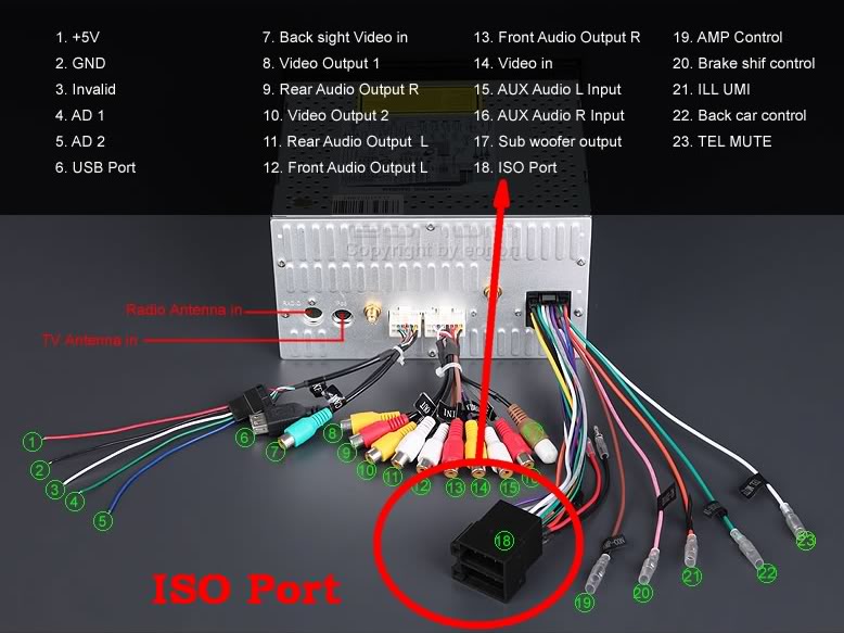

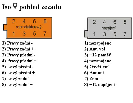

EONON, zapojeni power kablu
v manualu a na radiu je sice schema, ale nejsou tam cisla pinu, takze nevim, ktera barva kam vede. stacilo by i foto kabelu
dik

Dym ukáže kde bola chyba.......
>> > 1 - GND
>> > 6 - ANT
>> > 7 - Back car control cable ( Reverse cable)
>> > Back car control cable: After connecting it to the power, if there's
>> > no camera in, it will be blue screen. And it will display "RV" "BACK"
>> > or "CAM"on the screen. In this case, the buttons on the panel and
>> > remote controller can not work and there is no sound, no operation can
>> > be done. You need to connect the reverse cable to the reverse gear or
>> > reverse switch in your car If you don't use a reverse camera,you don't
>> > need to connect back car control.
>> > 8 - ACC
>> > 9 - BATT
>> > 14- Braking Shift control cable
>> > Braking Shift control cable: If it is not connected to Hand-brake
>> > switch, screen will display "Warning" and without picture. But the
>> > sound is OK. You need to connect the braking cable to the Ground
>> > cable.
>> > 15- illumination wire
>> > 16- Tel-Mute cable
>> > Tel-Mute cable: Connect it to the power, picture display will be OK.
>> > But there's no sound since it is in mute mode. If you don't have
>> > in-car telephone, you will not need to connect this cable. Connect it
>> > to the power, picture display will be OK. But there's no sound since
>> > it is in mute mode. If you don't have in-car telephone, you will not
