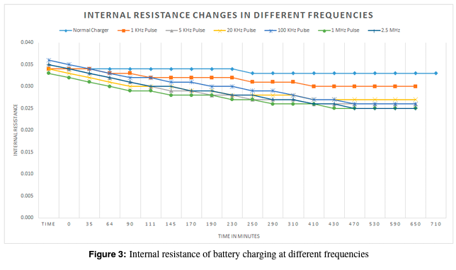

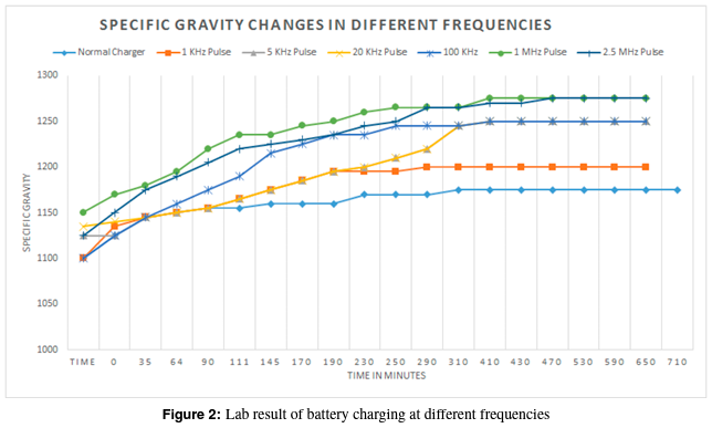

Zdroj: Experiment with desulfation of Lead-Acid Battery by High Frequency Pulse
EXPERIMENT
This experiment aimed to compare the effect of lead-acid batteries with sulfate on plates when charged with high frequency pulse. The experiment was divided into two phases. The first was battery charging with conventional chargers and the second was charging with high frequency pulse.
BATTERY
The batteries used in this experiment were lead-acid batteries FB EB125, which had been left unused for more than 6 months so sulfate built up on the plates of batteries resulted in an internal resistance higher than 20 mΩ and the fully-charged voltage dropped to 12.35 volts.
CONCLUSION
This experiment was a comparison between lead-acid battery charging with conventional chargers and lead-acid battery charging with high frequency pulse. The purpose of this study was to determine the effect of desulfation by high frequency pulse charging method. The results showed that after charging with high voltage, the internal resistance was lower. The fully-charge battery voltage and cold cranking amps were higher, resulting in better battery performance.
Další zdroj
Lab Test Results
In the experiment different batteries were tested using normal charger and pulsed charger. The frequency of the pulsed charger was set to 1 KHz, 5 KHz, 20 KHz, 100 KHz, 1 MHz, and 2.5 MHz in the tests. The charge level seems to reach above the level in the normal charger. Different effects can be seen in different charging frequencies. The comparison of the pulsed charging and normal charging is shown on the figures. The changes in the internal resistance is also shown for the different batteries. As seen in figure 2 the normal charger could charge only to the level of 1165 were as the highest was obtained at 2.5 MHz with the value 1275. The charge level reached at 5 KHz is 1250 which is a good level and not much less than in 2.5 MHz. Developing a high current charger at lower frequency is easier and economic too. Tests to carried in the field used the frequency of 5 KHz for the same reason. Internal resistance also decreased in pulsed charging but the change was more in the frequencies higher than 5 KHz, shown in figure 3. No significant effect is seen in 1 KHz. Data from the plot of internal resistance also suggests 5 KHz as optimum or usable.

akumulátor je chemický systém, jehož vlastnosti jsou závislé nejen na chemické čistotě použitého materiálu a na případném znečištění vnitřního prostředí článků při provozu, ale i způsobem jeho používání a dlouhodobou péčí o něj.
Výrobci u aku většinou udávají minimální dosažitenou (normovanou) kapacitu. Každý aku daného typu a výrobcem uvedené kapacity, může mít ve skutečnosti kapacitu trochu jinou.
I když nejdůležitějším parametrem u aku je jmenovité napětí a kapacita, nejsou to parametry jediné.
Z toho důvodu, můžou být odchylky na prezentovaných grafech zavádějící.
Pokud by se snad prováděly pokusy na stejném aku, pak se po dlouhodobé nečinnosti a z toho plynoucí míry sulfatace desek, jeho opakovanými nabíjecími a vybíjecími cykly, postupně část sulfátu na deskách rozpustila. Toho však můžete dosáhnout i nabíjením malým, jednocestně usměrněným proudem a tou zmíněnou malou žárovičkou, odebírající při takovém nabíjení asi 1/10 nabíjecího proudu.
Na obou prezentovaných grafech, levá strana na grafech, poukazuje na rozdílné startovací podmínky při testech.

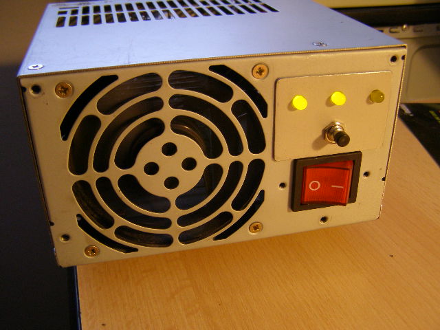

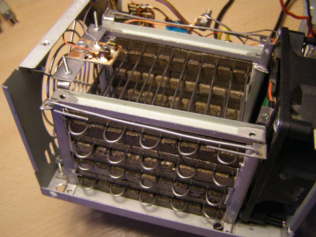

Děkuji všem za relevantní připomínky. Po té co se mi podařilo zvládnout výrobu šamotových trámečků držáku odporového drátu se ukázalo, že vyrobit nezničitelnou spirálu na koleně jde. Vyšlo to celé na cca 230Kč. Praskání šamotu na armatuře se nakonec ukázalo jako vhodná vlastnost, protože sestava pruží a tím pracuje s teplotou. Není to natvrdo. Vyndat armaturu šlo pouze kladivem, tak je to tvrdé. Na obrázku je konečná sestava, topný had 4m Kanthal průměr 1,2mm - 4x 1,2ohm.

Za sebe bych akci vybíječka uzavřel hlášením ze zatěžovacího testu. Při plné zátěži vychází z bedny vlažný vzduch, spirála ani nežhne, protože je řádně předimenzovaná. Bude to i požárně bezpečné.
Zapojení je tak triviální, že by ho zvládnul téměř každý. Pochybuju ale ,že to bude někdo dělat, dnes už se nebastlí ale nakupuje v Číně. Až mi to připadá, že vybitá baterka se nenabíjí ale vyhazuje. No všeho do času.
