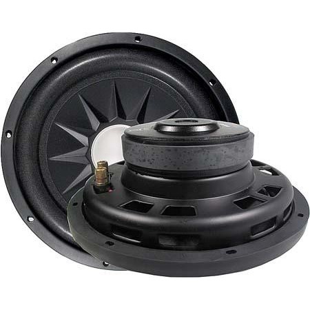

naladění subwooferu Q338
kde jsem udělal chybu?
Parameter, Value, Dim
Fs, 43.57, Hz
Re, 3.80, ohms[dc]
Le, 614.46, uH
L2, 2291.71, uH
R2, 42.93, ohms
Qt, 0.49, -
Qes, 0.53, -
Qms, 6.22, -
Mms, 66.31, grams
Rms, 2.919159, kg/s
Cms, 0.000201, m/N
Vas, 27.89, liters
Sd, 314.16, cm^2
Bl, 11.397389, Tm
ETA, 0.42, %
Lp(2.83V/1m), 91.55, dB
repro-255mm-10-basovy-4ohm-200w~velky.jpg- Q338 255mm-4ohm-200w
