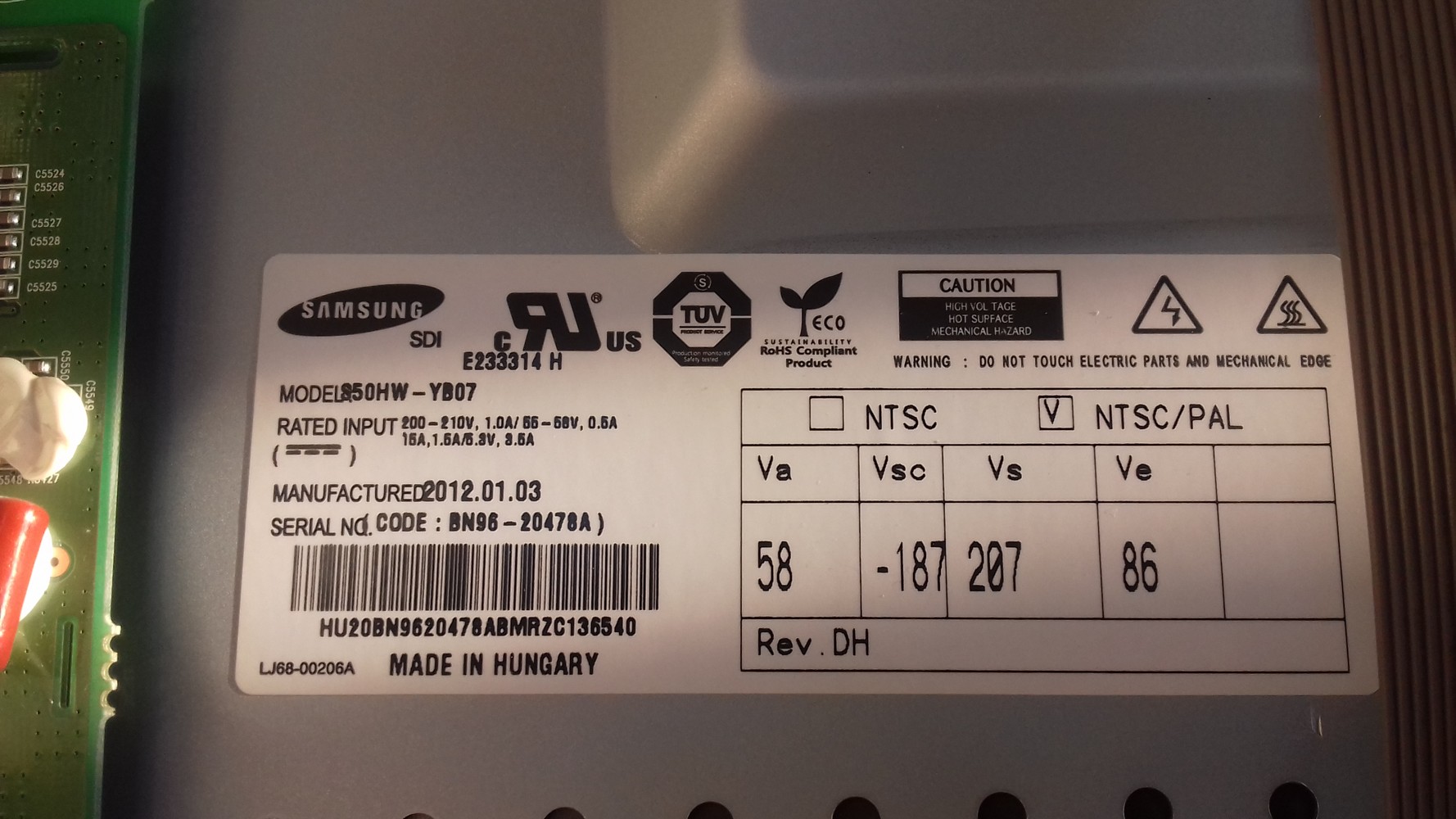

20160827_184757.jpg- (292.34 KiB) Staženo 175 x

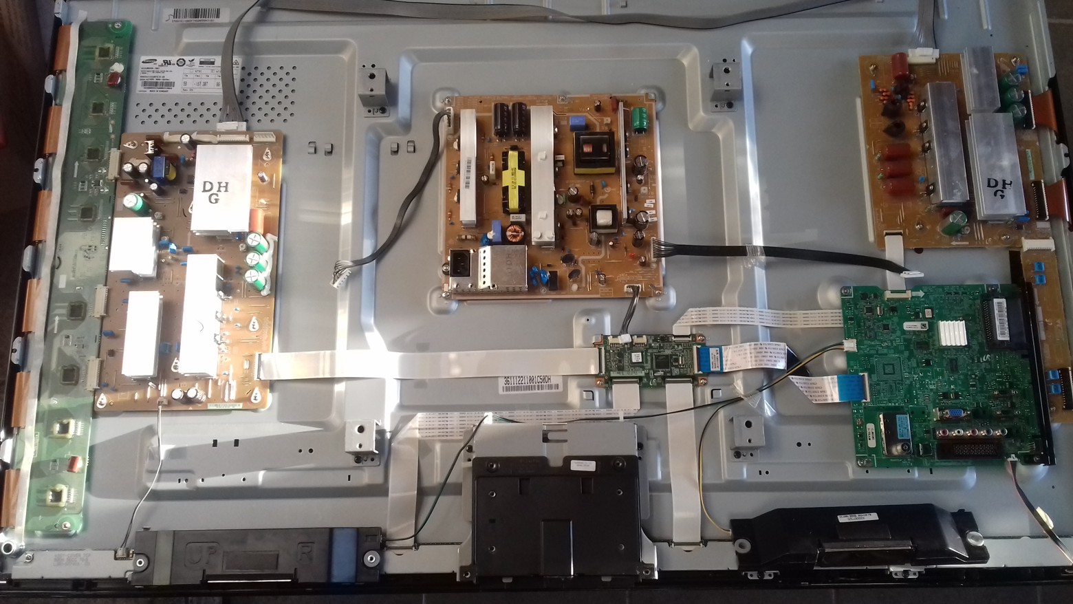

20160827_184429.jpg- (289.3 KiB) Staženo 204 x
