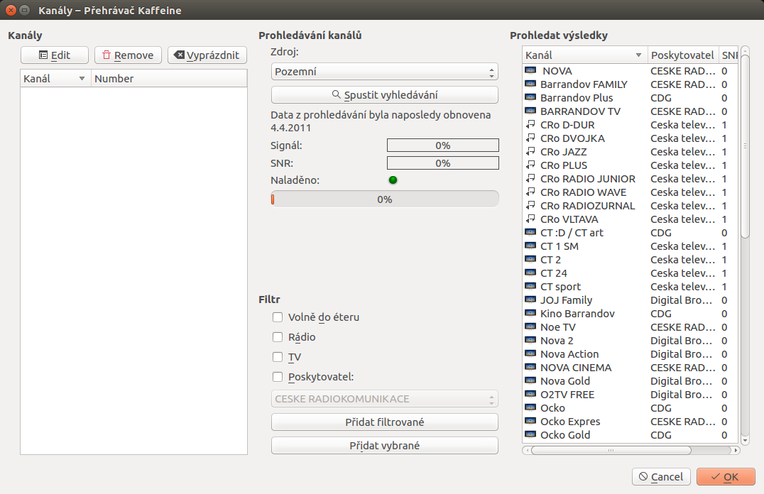

w_scan -c CZ výstup (mělo by to najít programy, ale nic nenajde):
570000: (time: 00:24.186) signal ok: QAM_AUTO f = 570000 kHz I999B8C999D999T999G999Y999 (0:0:0)
Info: no data from PAT after 2 seconds
deleting (QAM_AUTO f = 570000 kHz I999B8C999D999T999G999Y999 (0:0:0))
Standa99

Musíš si to hlídat ve výpisu dmesg, např. můj tuner, kterému chyběl firmware dvb-demod-mn88472-02.fw:
Kód: Vybrat vše
[ 2439.266993] usb 1-2: new high-speed USB device number 4 using xhci_hcd
[ 2439.802562] usb 1-2: New USB device found, idVendor=15f4, idProduct=0131
[ 2439.802563] usb 1-2: New USB device strings: Mfr=1, Product=2, SerialNumber=0
[ 2439.802564] usb 1-2: Product: dvbt2
[ 2439.802565] usb 1-2: Manufacturer: astrometadvbt2
[ 2439.875193] usb 1-2: dvb_usb_v2: found a 'Astrometa DVB-T2' in warm state
[ 2439.953395] usb 1-2: dvb_usb_v2: will pass the complete MPEG2 transport stream to the software demuxer
[ 2439.953400] dvbdev: DVB: registering new adapter (Astrometa DVB-T2)
[ 2439.969492] i2c i2c-1: Added multiplexed i2c bus 2
[ 2439.969493] rtl2832 1-0010: Realtek RTL2832 successfully attached
[ 2439.983598] mn88472 1-0018: Panasonic MN88472 successfully identified
[ 2439.983608] usb 1-2: DVB: registering adapter 0 frontend 0 (Realtek RTL2832 (DVB-T))...
[ 2439.983668] usb 1-2: DVB: registering adapter 0 frontend 1 (Panasonic MN88472)...
[ 2439.990685] r820t 2-003a: creating new instance
[ 2439.998120] r820t 2-003a: Rafael Micro r820t successfully identified
[ 2439.998123] r820t 2-003a: attaching existing instance
[ 2440.003260] r820t 2-003a: Rafael Micro r820t successfully identified
[ 2440.009482] media: Linux media interface: v0.10
[ 2440.015658] Linux video capture interface: v2.00
[ 2440.032244] rtl2832_sdr rtl2832_sdr.0.auto: Registered as swradio0
[ 2440.032245] rtl2832_sdr rtl2832_sdr.0.auto: Realtek RTL2832 SDR attached
[ 2440.032246] rtl2832_sdr rtl2832_sdr.0.auto: SDR API is still slightly experimental and functionality changes may follow
[ 2440.039445] Registered IR keymap rc-empty
[ 2440.039494] input: Astrometa DVB-T2 as /devices/pci0000:00/0000:00:0c.0/usb1/1-2/rc/rc0/input9
[ 2440.041593] rc rc0: Astrometa DVB-T2 as /devices/pci0000:00/0000:00:0c.0/usb1/1-2/rc/rc0
[ 2440.064959] usb 1-2: dvb_usb_v2: schedule remote query interval to 200 msecs
[ 2440.066686] lirc_dev: IR Remote Control driver registered, major 244
[ 2440.069804] rc rc0: lirc_dev: driver ir-lirc-codec (dvb_usb_rtl28xxu) registered at minor = 0
[ 2440.069805] IR LIRC bridge handler initialized
[ 2440.074379] usb 1-2: dvb_usb_v2: 'Astrometa DVB-T2' successfully initialized and connected
[ 2440.074410] usbcore: registered new interface driver dvb_usb_rtl28xxu
[ 2550.348068] mn88472 1-0018: Direct firmware load for dvb-demod-mn88472-02.fw failed with error -2
[ 2550.348075] mn88472 1-0018: firmware file 'dvb-demod-mn88472-02.fw' not found
!_důležité jsou poslední dva řádky_!
po dodání firmware:
Kód: Vybrat vše
[ 4027.864297] mn88472 1-0018: downloading firmware from file 'dvb-demod-mn88472-02.fw'
Potom w_scan funguje (částečný výpis):
Kód: Vybrat vše
w_scan
w_scan version 20141122 (compiled for DVB API 5.10)
guessing country 'CZ', use -c <country> to override
using settings for CZECH REPUBLIC
DVB aerial
DVB-T Europe
scan type TERRESTRIAL, channellist 4
output format vdr-2.0
output charset 'UTF-8', use -C <charset> to override
Info: using DVB adapter auto detection.
   /dev/dvb/adapter0/frontend0 -> TERRESTRIAL "Realtek RTL2832 (DVB-T)": good :-)
   /dev/dvb/adapter0/frontend1 -> TERRESTRIAL "Panasonic MN88472": very good :-))
Using TERRESTRIAL frontend (adapter /dev/dvb/adapter0/frontend1)
-_-_-_-_ Getting frontend capabilities-_-_-_-_
Using DVB API 5.10
frontend 'Panasonic MN88472' supports
DVB-T2
INVERSION_AUTO
QAM_AUTO
TRANSMISSION_MODE_AUTO
GUARD_INTERVAL_AUTO
HIERARCHY_AUTO
FEC_AUTO
FREQ (42.00MHz ... 1002.00MHz)
-_-_-_-_-_-_-_-_-_-_-_-_-_-_-_-_-_-_-_-_-_-_-_
Scanning DVB-T...
Scanning 7MHz frequencies...
177500: (time: 00:07.448)
Scanning 8MHz frequencies...
474000: (time: 00:25.487)
738000: (time: 02:29.972)         signal ok:   QAM_AUTO f = 738000 kHz I999B8C999D999T999G999Y999 (0:0:0)
        QAM_AUTO f = 738000 kHz I999B8C999D999T999G999Y999 (0:0:0) : updating transport_stream_id: -> (0:0:275)
        QAM_AUTO f = 738000 kHz I999B8C999D999T999G999Y999 (0:0:275) : updating network_id -> (0:12560:275)
        QAM_AUTO f = 738000 kHz I999B8C999D999T999G999Y999 (0:12560:275) : updating original_network_id -> (8395:12560:275)
        updating transponder:
           (QAM_AUTO f = 738000 kHz I999B8C999D999T999G999Y999 (8395:12560:275)) 0x0000
tune to: QAM_64   f = 738000 kHz I999B8C23D0T8G4Y0 (8395:12560:275) (time: 07:20.232)
   service = CT 1 SM (Ceska televize)
   service = CT 2 (Ceska televize)
   service = CT 24 (Ceska televize)
   service = CT sport (Ceska televize)
   service = CRo RADIOZURNAL (Ceska televize)
   service = CRo DVOJKA (Ceska televize)
   service = CRo VLTAVA (Ceska televize)
   service = CRo RADIO WAVE (Ceska televize)
   service = CRo D-DUR (Ceska televize)
   service = CRo RADIO JUNIOR (Ceska televize)
   service = CRo PLUS (Ceska televize)
   service = CRo JAZZ (Ceska televize)
Ať žije zdejší FOSILOVNA :D

Aha, ten konec v tom předchozím příspěvku nemáš. Podle výpisu dmesg máš vše dobře, pokud by byla chyba ve FW, tak by to snad vyřešila nějaká jejich aktualizace.
Před dalším w_scanem bych zkusil ten tuner odpojit a znova připojit z USB.
Popřípadě ještě vyzkoušej Kaffeine.
(157.5 KiB) Staženo 598 x
