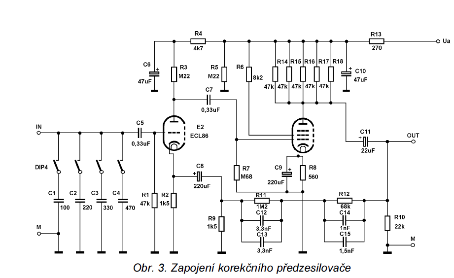

V PE 08_2001 až 10_2001 je pravděpodobně kopie konstrukce z Elektoru z roku 2000.
Vzorek:

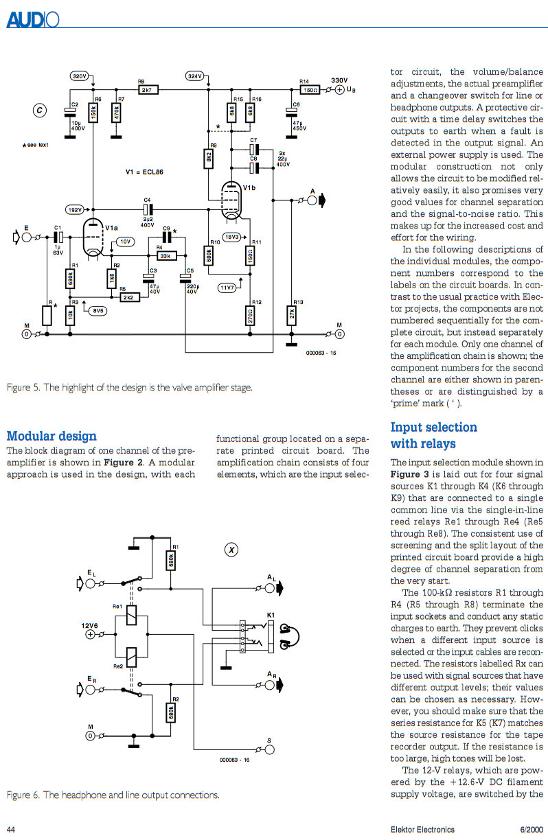

#5 Příspěvek od barnodaj »
Takto vypadá v Elektoru jeden z dílů, bohužel ten kus s RIAA předzesem nemám.

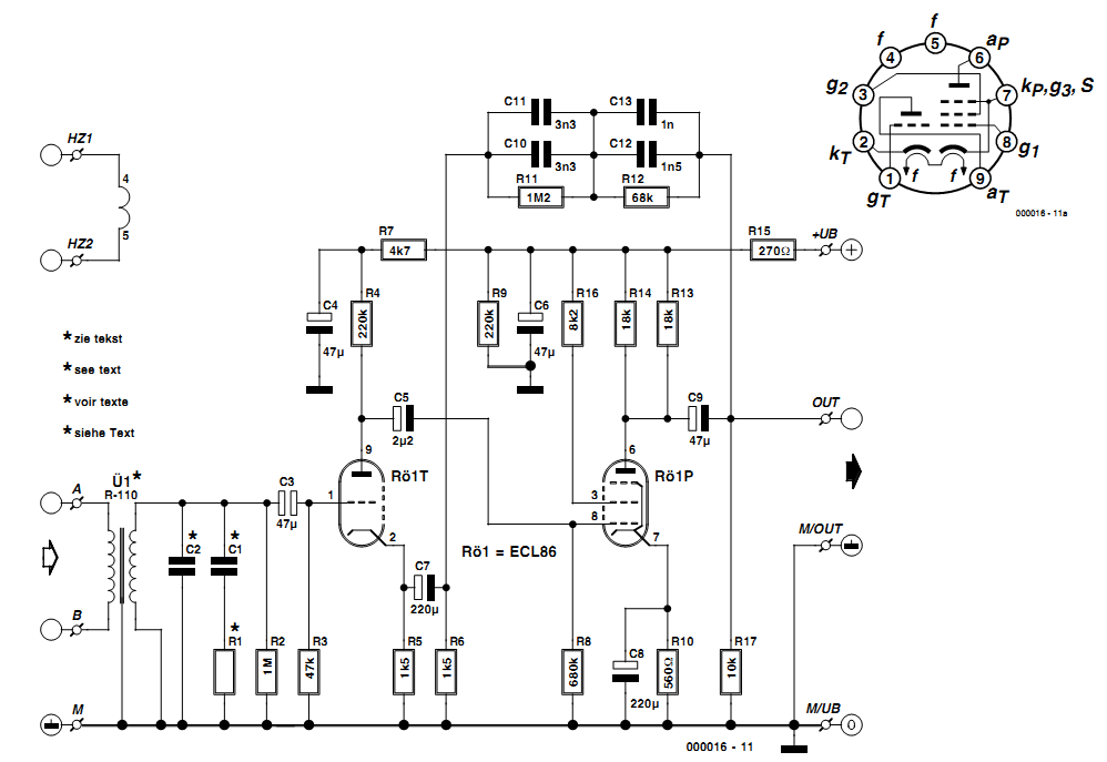

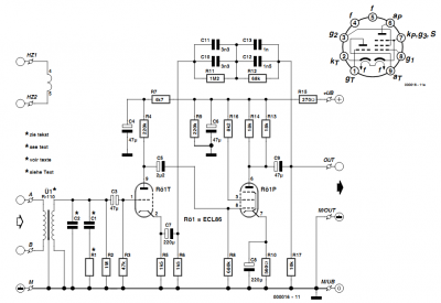

#7 Příspěvek od lesana87 »

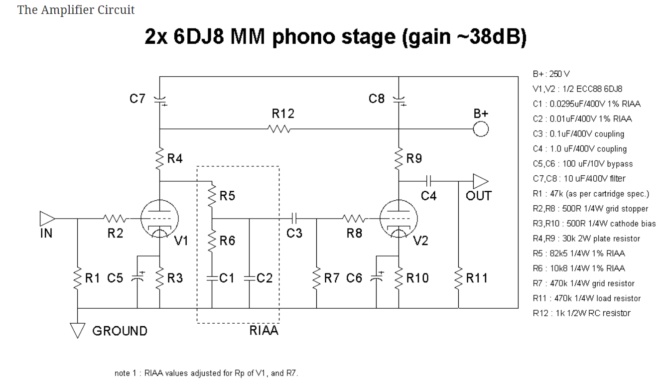

Tu je RIAA.
Edit: Z holandského Elektuuru jsem k hvězdičkovým součástkám přeložila googlem toto:
Meanwhile we have arrived at an interesting detail at the entrance of the circuit. When a conventional MM (Moving Magnet) or MD (Magneto Dynamic) pickup system is used, this can be connected directly to C3. Resistance R3 provides the standard shutdown value of 47 kΩ. The function of R2 is to derive any static stresses. For each MM system, there is a certain optimal value of the capacitive load, with the frequency characteristic running straight. Mostly, record players are equipped with a specific connection cable that is sized so that, together with the input capacitance of the amplifier, it forms the correct capacitive closing value. If the capacitive load is insufficient, this can be compensated with C2. A value between 10 pF and a few hundred picofarads is usual for this.
When a Moving Coil (MC) pickup element is used, an adaptation transformer at the input of the amplifier is necessary. A moving coil element has in principle clearly better display properties than an MM element. A disadvantage is that the MC element delivers a factor of 10 lower output voltage. This can be solved by means of transformer R110. This toroidal transformer has a mumetal shielding and transforms the signal voltage of the low-ohmic MC element up by a factor of 10 (20 dB) without the addition of noise and with a very low distortion factor.
The distortion depends on the input level and the frequency. The lower the frequency and the higher the level, the higher the distortion will be. Transformer R110 was measured with an input voltage of 1 mV, which is already a fairly high value for an MC element. The mumetal shielding of the transformer is pricey but absolutely necessary. All magnetically picked-up interference fields that end up in the core of the transformer are converted into voltages and deteriorate the original signal. In order for the transformer to function perfectly, a number of basic conditions must be met.
The voltage is transformed by a factor N = 10 while the impedance increases by a factor of N². If the transformer is terminated with an impedance of 47 kΩ, the MC element at the input will see an impedance of 470 Ω. This value must also apply to the low frequencies. With the value of C3 indicated in the diagram, the - 3 dB frequency is 0.07 Hz. Between the primary and the secondary winding, the transformer has a shield that conducts static interference to the ground.
To find a good seal for the moving-coil element, the specifications of the element must be consulted. For example, if a terminating resistance of 1 kΩ is required, the value of R3 must be increased to 100 kΩ. Resistor R2 can be omitted when using a transformer, because the transformer itself already shortens static voltages.
The frequency characteristic can be corrected with C2, C1 and R1. Capacitor C2 forms the aforementioned closing capacity. In certain cases, depending on the specific arrangement, a slight resonance phenomenon may occur in the audible frequency range. This resonance can then be attenuated by R1 and C1, as a result of which the frequency response is straight again. If R1 and C1 are required, the values are in the range of 22 pF to 1 nF and from 5 kΩ to 20 kΩ.

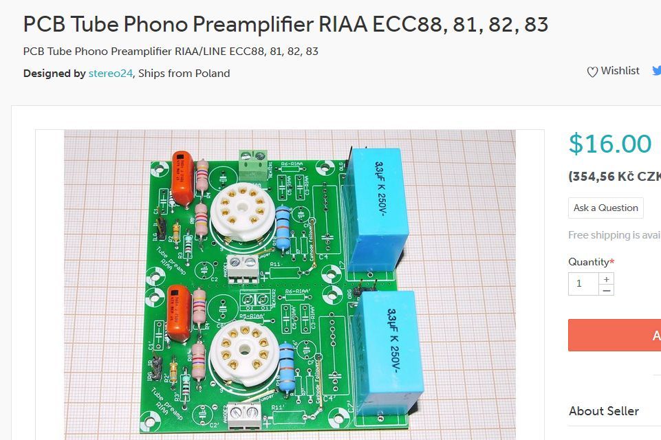

Příspěvky: 20886

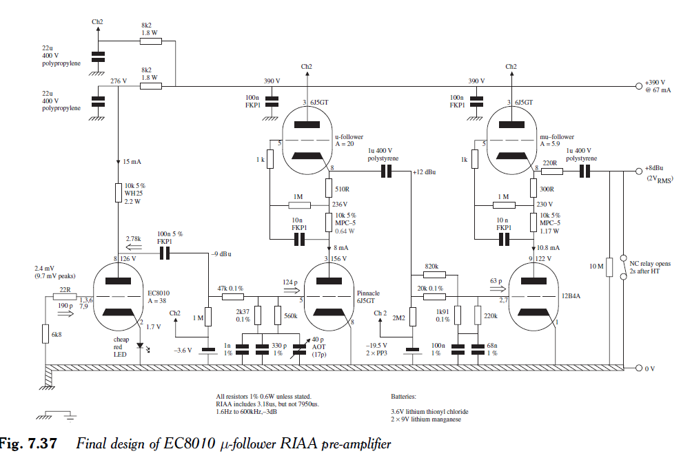

No pokud si chce navrhnou zes sám, tak stáhnout:
http://milas.spb.ru/~kmg/files/literatu ... dition.pdf

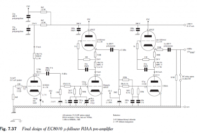

A může si navrhnout třeba něco takového:
(studium od str. 516)
Mimochodem, pokud by někdo věděl, kde stáhnout nějak inteligentně další vydání (4) té knihy?
