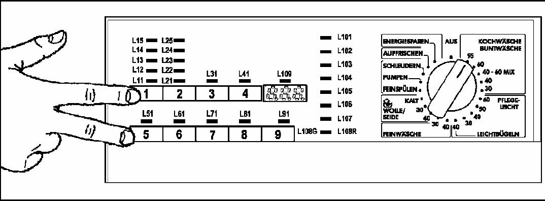

1. Cancel the set programme and switch the appliance off.
2. Press buttons 1 and 5 simultaneously and then, holding them down, switch the appliance on by rotating
the programme selector of one position clockwise.
In the first position the function test of the buttons and the corresponding LEDs is performed; by rotating the
programme selector clockwise the operation diagnostics of each component and the reading of the alarms
is carried out.
9.2 Exiting diagnostics system
To exit the diagnostics system switch the appliance off, on and then off again
29_1263668850.jpg- (68.79 KiB) Staženo 312 x
