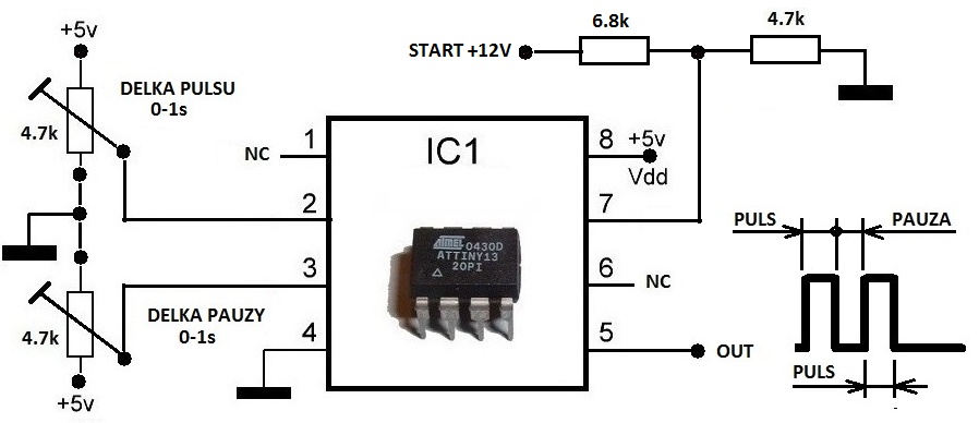

tady mas navrh, jak by to mohlo vypadat ...
(60.95 KiB) Staženo 102 x
